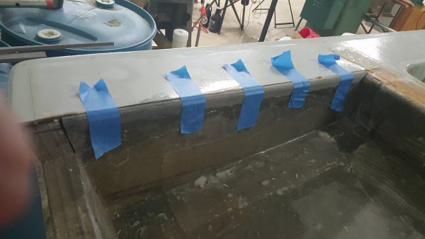

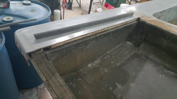

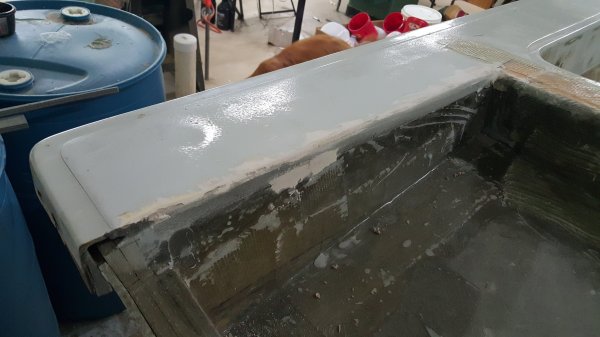

    Got a bit done this weekend - pictured is the port side of the motorwell with fill strip installed. I used jelly as a bonding agent. The starboard side got the same treatment. Rather than wait until a major spring/summer holiday when everyone comes to the cabin I decided to tow the boat the 260 miles South to my home so I could get some bodies to help me flip it. That will happen tomorrow morning and I have a carport to keep it in. I also brought enough supplies to keep me busy for awhile. The nice thing about Southern AL is that I can work outside most of the winter without bothering the wife with fiberglass fumes.

    I have made 2 intermediate mistakes but think I have mitigated them, but would like 2nd and 3rd opinions. #1 - when I made the area to hold the fin mounting block of plywood I filled it with resin. Pure resin is like window glass in that it is easily breakable. I did however cover the whole thing with 2 layers of thick cloth and even built an access hole to get to it in the event of a problem. The bottom of that mounting block is the shell of the hull so at least that block is surrounded by strength. #2 - Same deal on the transom. When I installed the 1/2" coosa X 3 into the back of the boat there were some voids on the edges after I glassed it in. Roughly 1.5" x varying amounts not more than 5/8" . I poured pure resin into the 2 holes. Hopefully I have enough stringers etc to provide sufficient transom stiffness. I am adding additional structural stiffness by replacing my old thin plywood motorwell with a coosa sheet thorougly glassed on both sides to tie it in with the rest of the box structure. That bottom motorwell coosa piece is also intended to hold a ski pole vertical. I think this should do it.

    This is the hull with the extra knees or kickers in it, correct? Initially I would have been concerned about flexing and the pooled resin cracking, but your transom should not flex. Those solid sections are well supported by the extra knees tying the transom to the floor.
    The fin, the solid resin is more like a high density core material at this point. The glass on either side is what is going to carry the loads.
  7. tj309
    Yes this the 5 knee hull except knees 2 and 4 are also splashwell sides all the way down to the core and form a 5 sided box. I can't think of a stronger way to build this. As far as the fin goes I did leave a 6" access hole and maybe I will lay down some more glass in there just to be sure.
