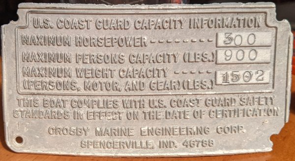

    My '78 18' Skier has a rateing of 300hp

    Capacity plate from a 1978 18 foot Hydrodyne.
